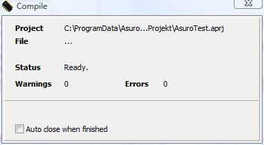

    Hi Osser, danke für deine Antwort. Ich hab alles so eingestellt wie du es bei dir auch hast (im Bild), hab auch die neue Version von AF installiert.
    Wenn ich auf "Make All" klicke kommt ja dieses Fenster:
    da steht ja Errors: 0 und Warnings: 0
    aber in dem Fenster unten wo der Text drin steht:
    >Session Environment Variables:
    AF_AVRDIR=C:\WinAVR-20100110
    AF_PROJECT=AsuroTest
    AF_SOURCE_FILES=test.c asuro.c
    AF_ASM_SRC_FILES=
    AF_PRGDIR=C:\Program Files\AsuroFlash
    AF_PRJDIR=C:\ProgramData\AsuroFlash\Projects\TestA suroProjekt
    AF_ASURO_LIB_PATH=%AllUsersProfile%\asuro_lib\lib
    File test.c saved.
    File asuro.c saved.
    File asuro.h saved.
    >Default make_all.cmd file created.
    >Default makefile created.
    Make
    C:\ProgramData\AsuroFlash\Projects\TestAsuroProjek t>C:\WinAVR-20100110\utils\bin\make.exe all
    set -e; avr-gcc -MM -mmcu=atmega8 -I. -g -Os -funsigned-char -funsigned-bitfields -fpack-struct -fshort-enums -Wall -Wstrict-prototypes -Wa,-ahlms=asuro.lst -IC:\Program Files\AsuroFlash\include asuro.c \
    | sed 's,\(.*\)\.o[ :]*,\1.o \1.d : ,g' > asuro.d; \
    [ -s asuro.d ] || rm -f asuro.d
    avr-gcc.exe: FilesAsuroFlashinclude: No such file or directory
    set -e; avr-gcc -MM -mmcu=atmega8 -I. -g -Os -funsigned-char -funsigned-bitfields -fpack-struct -fshort-enums -Wall -Wstrict-prototypes -Wa,-ahlms=test.lst -IC:\Program Files\AsuroFlash\include test.c \
    | sed 's,\(.*\)\.o[ :]*,\1.o \1.d : ,g' > test.d; \
    [ -s test.d ] || rm -f test.d
    -------- begin --------
    avr-gcc --version
    avr-gcc (WinAVR 20100110) 4.3.3
    Copyright (C) 2008 Free Software Foundation, Inc.
    This is free software; see the source for copying conditions. There is NO
    warranty; not even for MERCHANTABILITY or FITNESS FOR A PARTICULAR PURPOSE.
    avr-gcc -c -mmcu=atmega8 -I. -g -Os -funsigned-char -funsigned-bitfields -fpack-struct -fshort-enums -Wall -Wstrict-prototypes -Wa,-ahlms=test.lst -IC:\Program Files\AsuroFlash\include test.c -o test.o
    In file included from asuro.h:145,
    avr-gcc: Files\AsuroFlash\include: No such file or directory
    make: *** [test.o] Error 1
    from test.c:9:
    c:/winavr-20100110/lib/gcc/../../avr/include/avr/signal.h:36:2: warning: #warning "This header file is obsolete. Use <avr/interrupt.h>."
    ExitCode 2
    >Ready.
    Da sind ja Errors drin nur wie kann ich die "beheben" ?
    Weist du wie ich das machen sollte?
